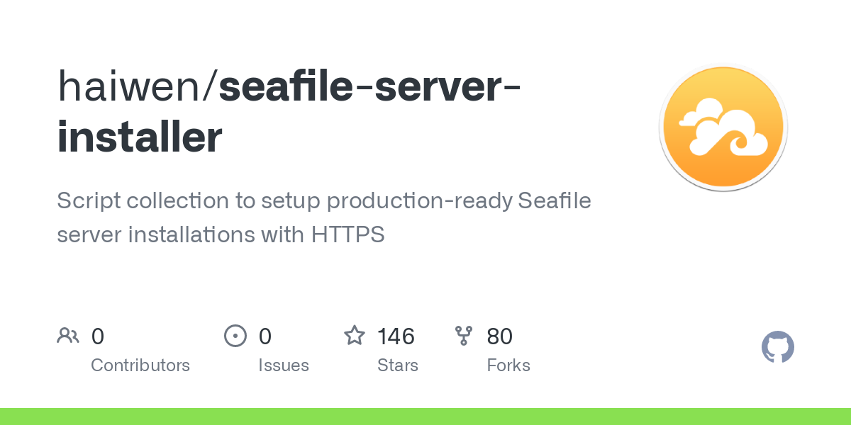

If you are willing to re-setup, I would use the haiwen script from github:
I would be happy to give you a run-down on how to set it up with this, and where all of the passwords are stored for if you need them.
