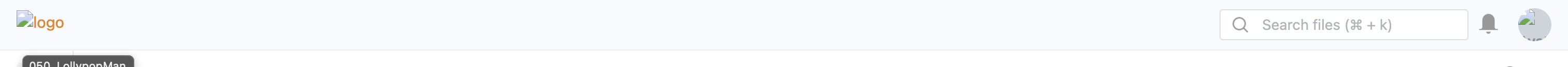

Seafile 12 issue with logo / user picture
I tried uploading a new logo and a user picture and it always appears broken, nothing else seems to have problems on the server side, but this stuff just seems iffy, whats the fix?

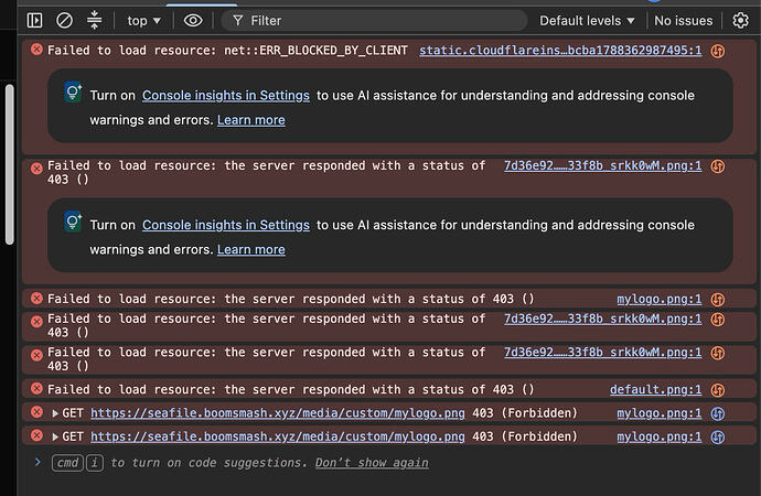

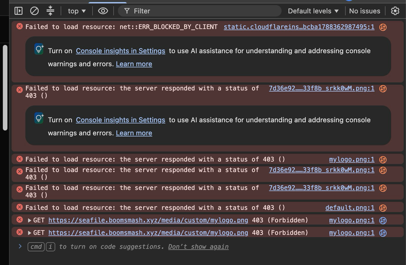

this is what the console says:

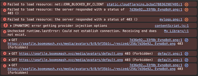

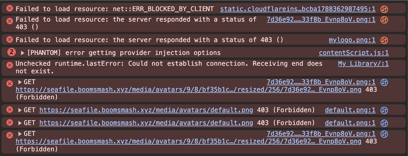

I went into the activities tab and i got this:
I

i dont know what more of the console error i can share, its all i see, is this and dont see much to expand
