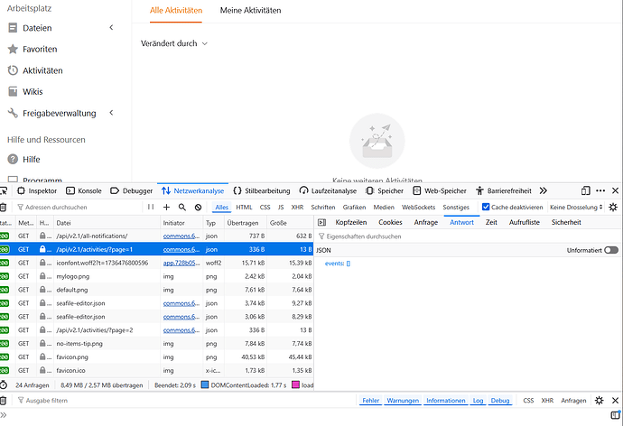

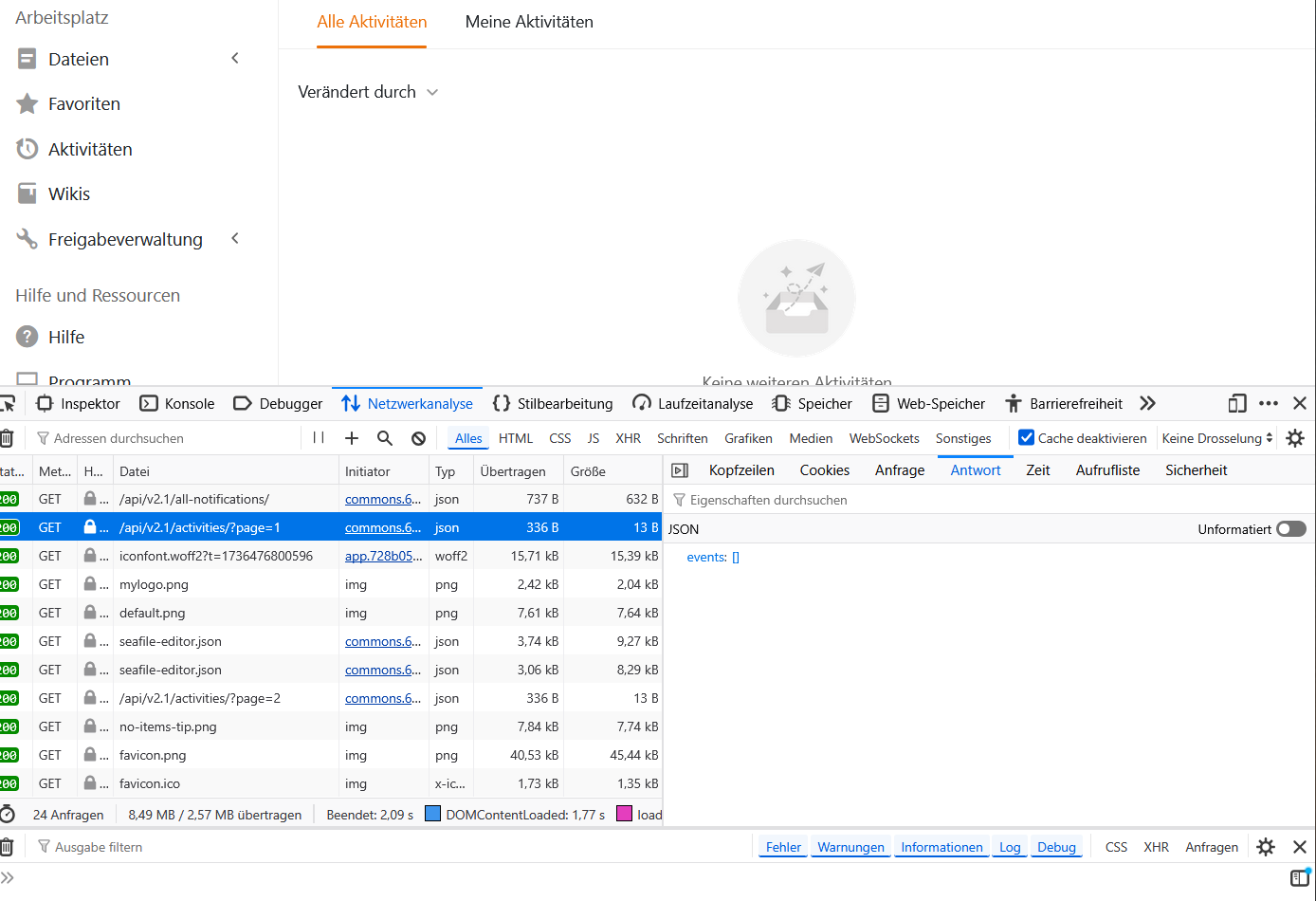

In Seafile 13.0.19, no activities have been visible in the web interface for several days. I then cleared the Activities table and restarted Docker. New activities are appearing in the table, I’ve checked. But the web interface still isn’t showing any. Does anyone have any ideas? I’ve also checked the time; CET is set everywhere on the Ubuntu server, in Docker, and in the Seafile .env file. The entries in the Activities table are all in datetime format. The server wasn’t an upgrade from version 12, but a fresh install of CE Ubuntu Docker 13.0.18. The activities were visible initially.
Since you have confirmed that the activities are being correctly written to the database table but are not rendering in the web interface, the issue likely lies in the communication or filtering layer between the database and the Seahub API.
Here are a few specific things you should check:

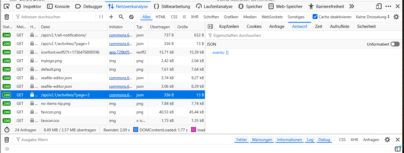

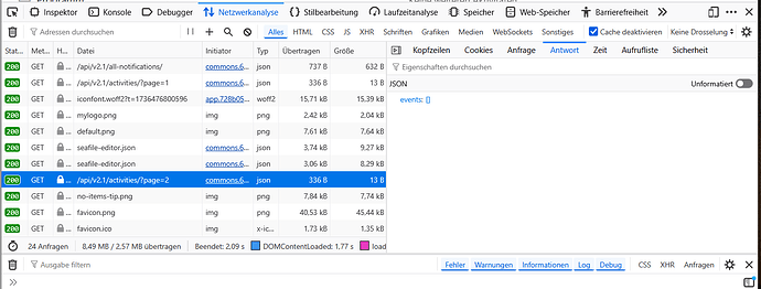

  1. Check Browser Network Response (F12): Open your browser’s Developer Tools, go to the Network tab, and refresh the Activities page. Look for the request to /api/v2.1/activities/.
  • If it returns 200 OK but the response body is an empty list [], it means the backend is successfully querying the database but filtering out all results (often due to a timezone mismatch).
  • If it returns a 500 Internal Server Error, there is a crash occurring during data serialization.
  1. Verify Timezone Configuration Format: Seafile (Django) expects specific timezone strings. Ensure that your TIME_ZONE setting in your configuration (often in the .env file or seahub_settings.py) is set to a long-form identifier like Europe/Berlin rather than just CET. If there is a discrepancy between the database’s UTC storage and the application’s timezone interpretation, activities can be filtered out as “future” events and won’t display.
  2. Check for Stale PID Files: Sometimes the seafevents process (responsible for the activity feed) can encounter issues if a stale .pid file exists from a previous restart. Check your pids/ directory inside the Docker volume. if seafevents.pid exists but the process isn’t healthy, try deleting the .pid file and restarting the container.
  3. Inspect seahub.log and seafevents.log: Look for any “Incorrect string value” or “DataError” messages. In some cases, if an activity contains a special character that the Python backend fails to serialize into JSON, the entire API call might fail or return an empty set.
729
The API calls all return 200, so that’s okay. I’ve set the timezone in the .env file to TIME_ZONE=Europe/Berlin, and I have the same setting in the Docker environment and on the Ubuntu host. However, I’m using a custom Docker image with its own integrated CA, and it’s possible I built it before adjusting all the timezones. Could it be that the custom Seafile image still contains UTC somewhere, causing my problems? If so, I’d rebuild it and see if that fixes it. But even if there are differences—the image is running on UTC while the server and environment are on Europe/Berlin—shouldn’t something eventually show up? That’s what’s puzzling me. The PIDs creation times are all fresh, no old one hanging.
In the seahub - und seafevents.log there are no data errors or something, the seafevents looks pretty good, I think:

Another info:
The entries shown in the webinterface stopped a view days ago. But they was shown. After deleting all entries in the 3 Activity-Tables there was not shown anything in the webinterface. So it must be anything not to be delivered to the webinterface, I think.
From your logs, we can confirm that:
  1. The backend is working: seafevents is successfully recording file operations and updating the Activity and UserActivity tables (e.g., Activity ID 98 was recently mapped to many users).
  2. The API is alive: Since you are getting a 200 OK on the /api/v2.1/activities/ call, the web server is processing the request.
Suggested Next Step
We can check what the server is sending back to your browser.
  1. Open your browser’s Developer Tools (F12) and go to the Network tab.
  2. Refresh the Activities page in the Seafile web interface.
  3. Click on the request named activities/ (the URL ends in /api/v2.1/activities/).
  4. Look at the Response or Preview tab.
What to look for:
  • Scenario A: The response is {"activities": []} (an empty list). This confirms that the backend is querying the database but filtering the results out before sending them to the UI.
  • Scenario B: The response actually contains data (JSON with activity details). If the data is there but the screen is blank, the issue is with the frontend Javascript rendering (perhaps a browser cache issue or a conflict with your custom integrated CA/HTTPS setup).
In Scenario A, you may add debug code to /api/v2.1/activities/ API point to further analyze the issue.
There are 2x activities in the network tab, here are the results in a screenshot:
