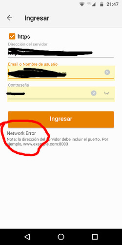

Dear, thank you very much for taking the time to read my question, I am experiencing problems with version 8 of android and the client of seafile, the same one tells me network error without giving much more information. in the server I do not see the request, neither in the DNS nor in the firewall, it is worth clarifying that the seafile service is internal and I do not publish, I do not know if that affects something, but what strikes me is that it only happens to me with android 8.
Attached a capture along with the versions of seafile that I am using, if you need some more information please just advise

Can you access from the device over the web browser?
thank you very much for the answer, that is the most crazy thing, yes, I can access seafile perfectly from the web browser, even in old phones it works normally just happens with android 8 this
You need to set the port on the URL (https://your.server.local:<port number>/). This issue might be related to HTTPS, since Android 7 apps by default don’t trust certificates added by the user (which is insane because the main purpose of having a certificate store is that your system should trust what it’s put in there).

Gracias por responderme en español, mi ingles es muy malo y me cuesta mucho comprender… lo mas raro es que solo me pasa cuando le utilizo desde la ip privada, cuando estoy fuera de la red y lo acceso por la ip publica funciona sin importar el certificado que le ponga, probe incluyendo uno de let’s encrypt y paso igual
Ya intente lo del puerto me que mencionas pero eso no cambio el resultado, el problema es que el error no s muy descriptivo y no se muy bien como hacer debug para ver el problema.

Si, eso lo tuve en cuenta, en el DNS publico resuelve seafile.dominio.com A ip_publica, y luego dentro de mi LAN tengo un DNS que resuelve seafile.dominio.com A ip_privada, este escenario me funciono perfectamente hace hace unos dias que empezaron a llegar las primeros motog6 con android 8 y dejo de andar solo en esas terminales, las notebook, sin importar el SO que tenen instalado funcionan correctamente. en ambos funciona con el mismo certificado uno generado por let’s encrypt. Lo mas extraño es que en el log del DNS no veo ni el pedido para la resolucion del nombre, ni hablar de ver el request al nginx
Spanish:
Probá revisando el log de android con logcat, necesitamos más detalles
https://developer.android.com/studio/command-line/logcat?hl=es-419
