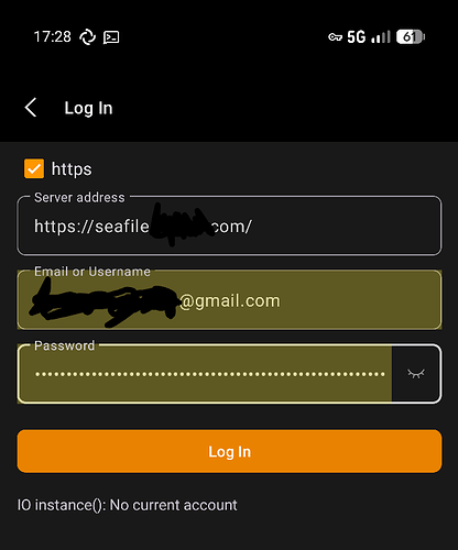

I am a long time user of Seafile and very happy with my self-hosted Docker instance. All was working fine up to Android version 4.0.3. After updating a logged on account remains logged on, but I cannot logon using version 4.0.4. The error message is:
IO Instance(): No current account
When I downgrade the Android app to 4.0.3 I am able to logon again. I am using an mTLS capable HAProxy but I have already redirected traffic through a non-mTLS capable HAProxy and got the same result. When I provide the username and password and press logon normally the 2FA field pops-up allowing me to put in the 2FA code, on 4.0.4 I get the mentioned error. I see no http requests hitting the HAProxy so it looks like a local problem? I have looked at the GIT delta between 4.0.3 and 4.0.4 and there are 2 exceptions it can throw:
and
IO Instance(): No current account?
According to GitHub: /haiwen/seadroid/compare/v4.0.3…v4.0.4
app/src/main/java/com/seafile/seadroid2/framework/glide/SeafGlideCache.java has the exception with question mark so I don’t think I’m hitting that. app/src/main/java/com/seafile/seadroid2/framework/http/HttpManager.java holds the same exception without question mark so I guess I’m hitting that?

I forgot to mention I’m running GrapheneOS so it might be some restriction causing this issue, I have provided the app with full permissions and disabled hardening. Up to 4.0.3 all was fine on GrapheneOS. Anyone else facing this issue?
@pakjebakmeel
This issue has been fixed and has been published to Github Releases(v4.0.5), where you can download and update it.
I have updated to 4.0.5 and can confirm that login is working again.
Thank you so much for the quick fix! :+1:
