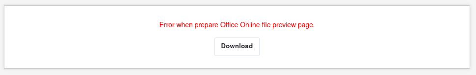

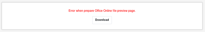

Thank you for the suggestions. I created a new entry for collabora on my Pangolin pointing to the IP address of my docker host and port 6232. I also updated the OFFICE_WEB_APP_BASE_URL line in seahub_settings.py according to your suggestions. Now I’m getting the following error, when I trying to open a document:
When I open the https://collabora.mydomain.xyz site, it says: “Client sent an HTTP request to an HTTPS server.”
When I change the host address from http://192.168.1.241:6232 to HTTPS, it just saying “Bad Gateway”.
Do you have any further suggestions that I could try?
