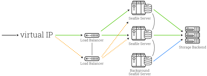

I have some question about the usage of the health check port 11001 of seafile. For a better understanding I made a picture:
In addition here is the link to the releveant seafile manual entry:
https://download.seafile.com/published/seafile-manual/deploy_pro/deploy_in_a_cluster.md#user-content-HAProxy
In my understanding the “health check port” 11001 is used by the load balancers (e.g. haproxy) to get to know which seafile node is ready for incoming connections. As long as the load balancer reaches port 11001, requests to this frontend node are also routed.
Question 1: did I understand the meaning of the health check port correctly?

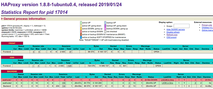

If so, I have a huge problem with the health check port. This seems to be tied to the Seafile service. It does not test whether seahub, database or a web server is running. What did I do: I just tried:
- systemctl stop seahub
- systemctl stop nginx
- systemctl stop mariadb
In all three cases, seafile was not usable anymore but the front node was still accessible to haproxy. “Status UP”. Only when I stopped the seafile service, haproxy recognizes the node as “Down” and no longer forward requests.
