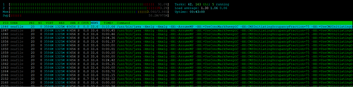

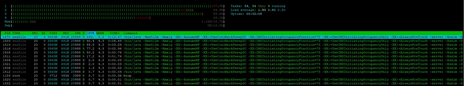

i am using seafile pro 7.0.7 on a debian buster root server and started to notice something that seems suspicious to me. When i start htop there are several java entries that repeatedly seem to consume lots of cpu for a few seconds. After that the cpu load seems perfectly normal until it comes up back again like you see in the picture.
Even though there are no obvious problems when we are using seafile so far i still would like to know
if this is intented or something i should look into more closely.

I can confirm what you described. Immediately after setting INDEX FILES to false, the high CPU load disappears completly. You might also be able to install elasticsearch seperately and set the
es_host and and es_ports setting in seafevents.conf accordingly.

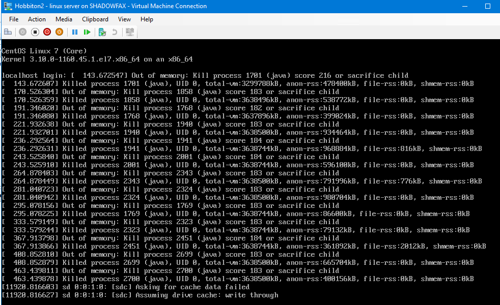

Replying to old topic but I’m having trouble in my private Seafile Pro system (3 user). I’ve been running community edition for several years with just 2GB RAM on my Linux system. But since upgrading it to Pro a few weeks ago, I’ve had to increase RAM to 4GB and I’m periodically getting these errors on the console:
