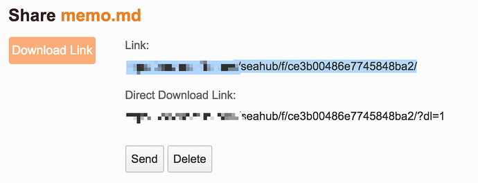

Is it limited to a folder ? I can’t find this feature.
Regards,
Gautier

It is not limited to a folder. You can find the feature in sharing dialog.
