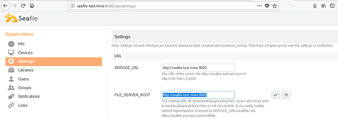

I solved the last problem with Seafile. Turns out the default settings are wrong.
Changing the FILE_SERVER_ROOT value inside System Admin\Settings\ from http://seafile-test.mine/seafhttp to http://seafile-test.mine:8082 resolved the issue with downloading or uploading via the web interface.
