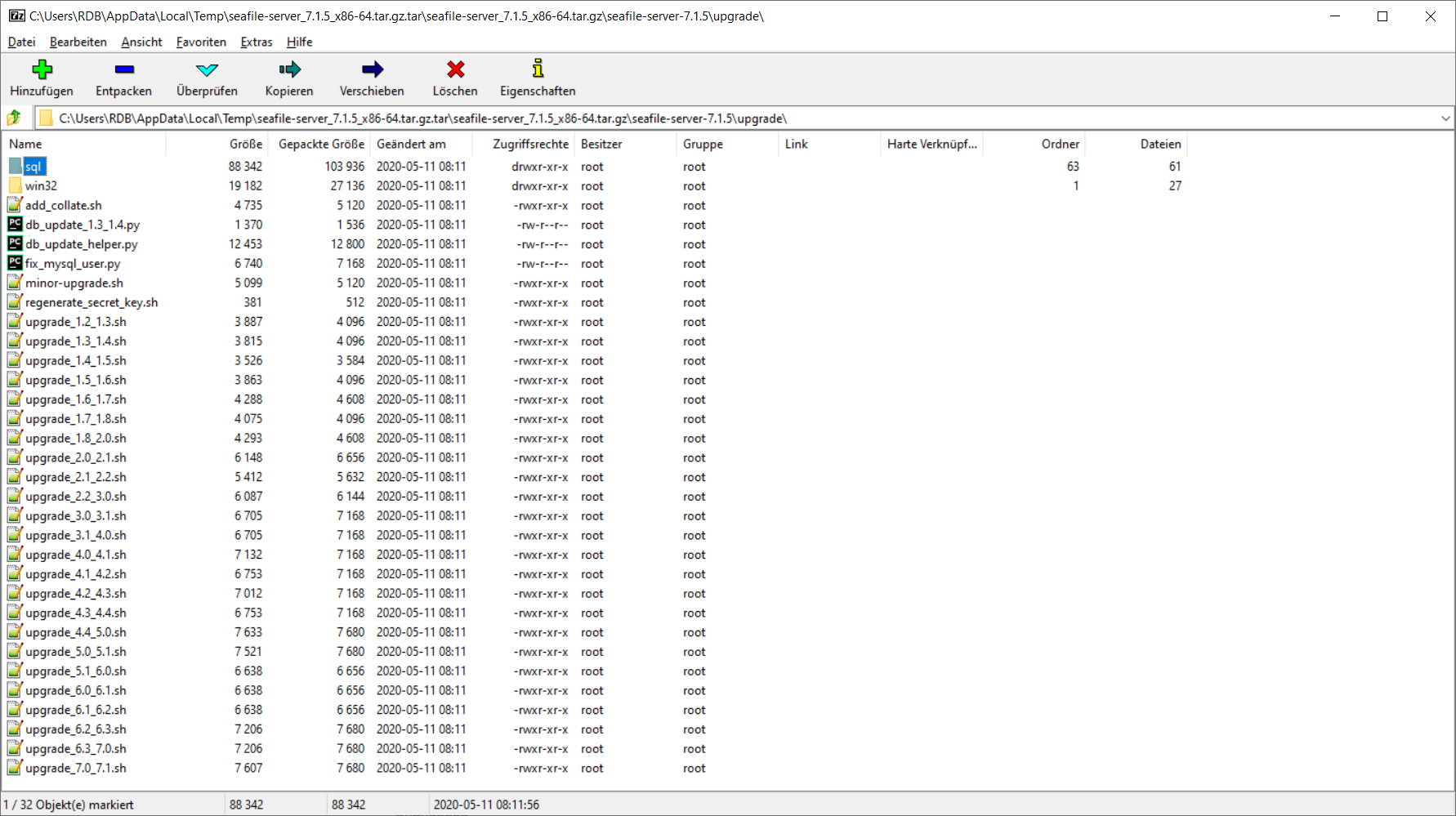

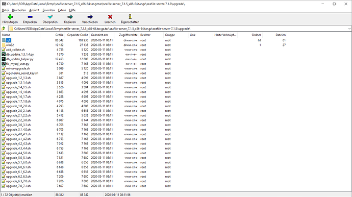

The upgrade directory in the seafile-server.tar.gz contains a folder “sql” which contains the sql statements executed when upgrading. You can perform these manually to prepare the dump made on your Seafile 6.x for import in Seafile 8.x
I don’t recommend doing that, but you asked.
If I were you, I’d start from scratch: Install Seafile 6.0.4 on Debian 10, sync the data from old to new and import the db dumps, and upgrade from 6.0 to 8.0 on the new server.
