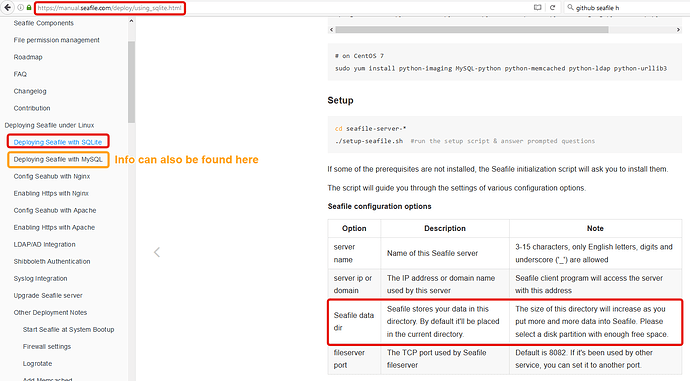

sounds like its running properly now. I guess you already know: if you have installed seafile by using the default paths (by following the documentation), your files might be stored all into the /home folder. that means you might reach your seafile storage maximum at ~10gb. of course your partition(s) can be resized to overcome that limitation.
I use the installer script found at https://github.com/haiwen/seafile-server-installer/ which uses a default data dir of /opt/seafile/seafile-data/ and yes I got it working.
thanks a lot for sharing this hint. then you re surely not running into any storage problems;) I ve had to use https://manual.seafile.com/deploy/ since my apache multi configuration etc is more complex. interesting that the deployment dirs are different: /opt/seafile vs. /home/(user/)seafile. not a problem; just important to mention if some beginner doesnt know how to start… can be installed under theoretically any directory.
