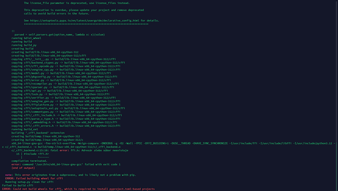

Install manual claims this version:
cffi==1.15.1
I’m running 1.16.0 - seems to work as well.
