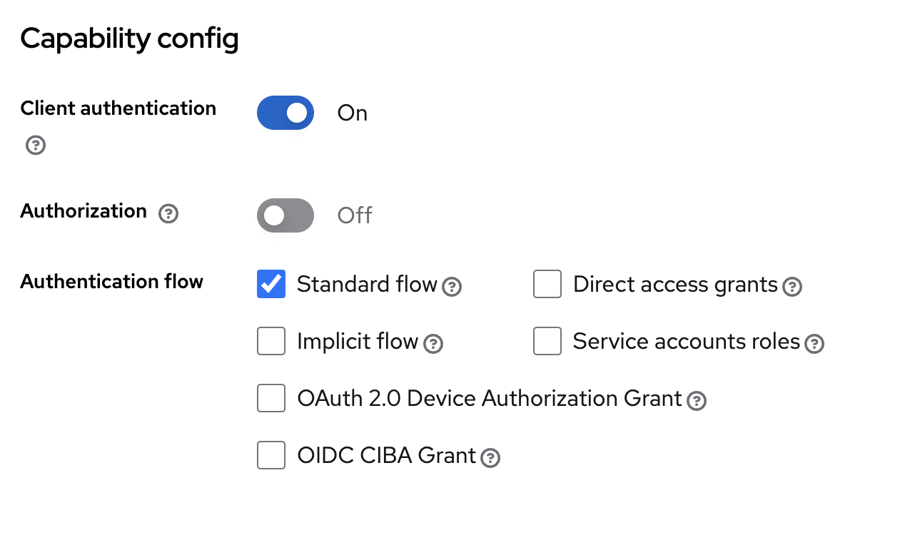

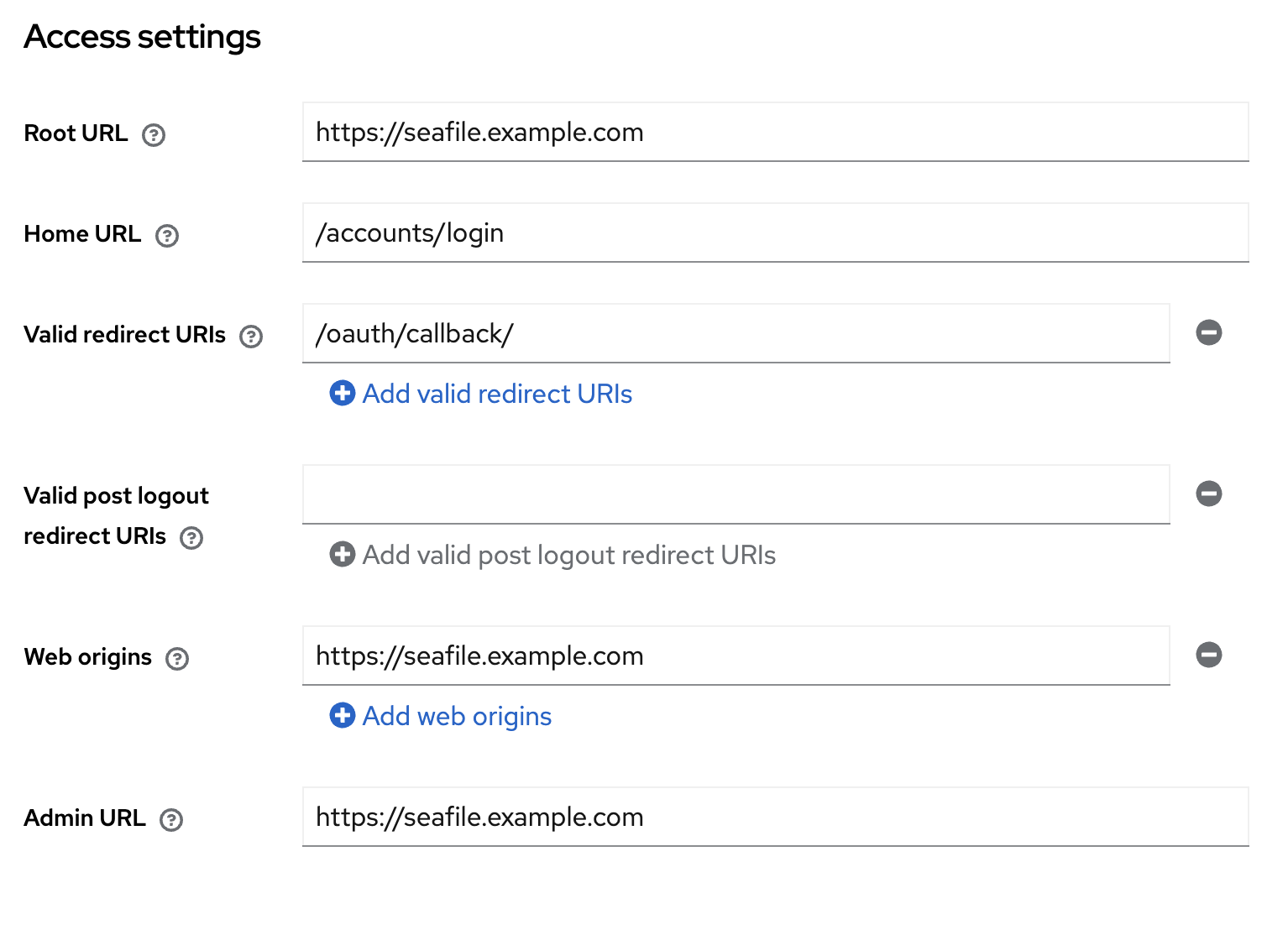

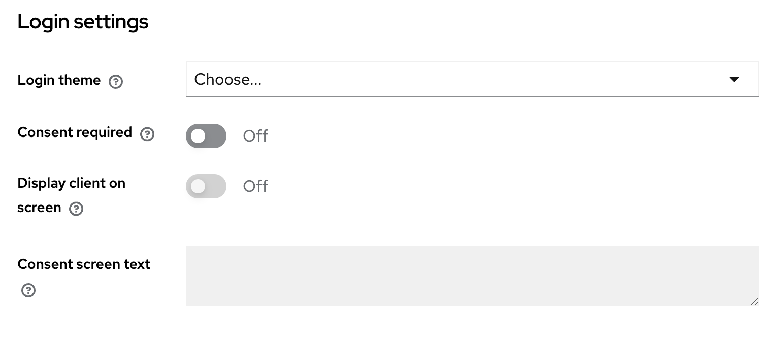

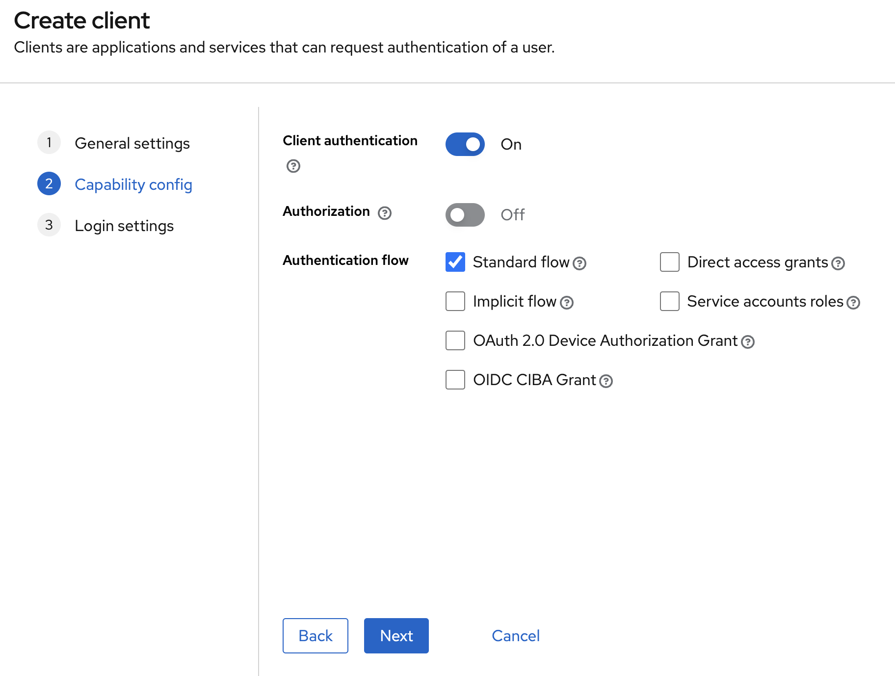

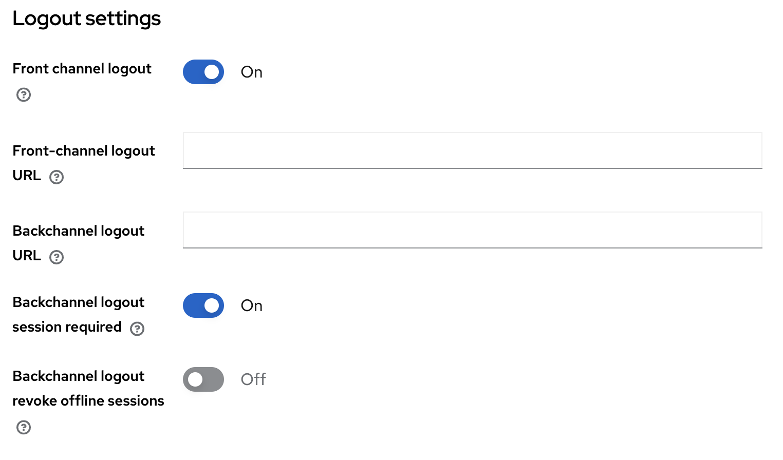

To start with, you’ll need to set up an OpenID client in Keycloak. You can use settings like these for it (though adding additional randomness to the client ID can increase the effective complexity of the secret).
That should give you a client that looks something like this:

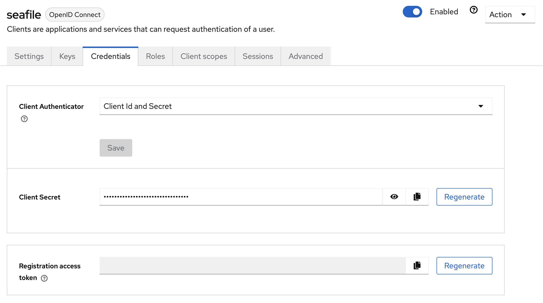

You should also have a credentials tab (which is made available by turning on client authentication):
The client secret will be used in the Seahub configuration, so you’ll want to click the copy button to get a copy of it and paste it somewhere temporarily.

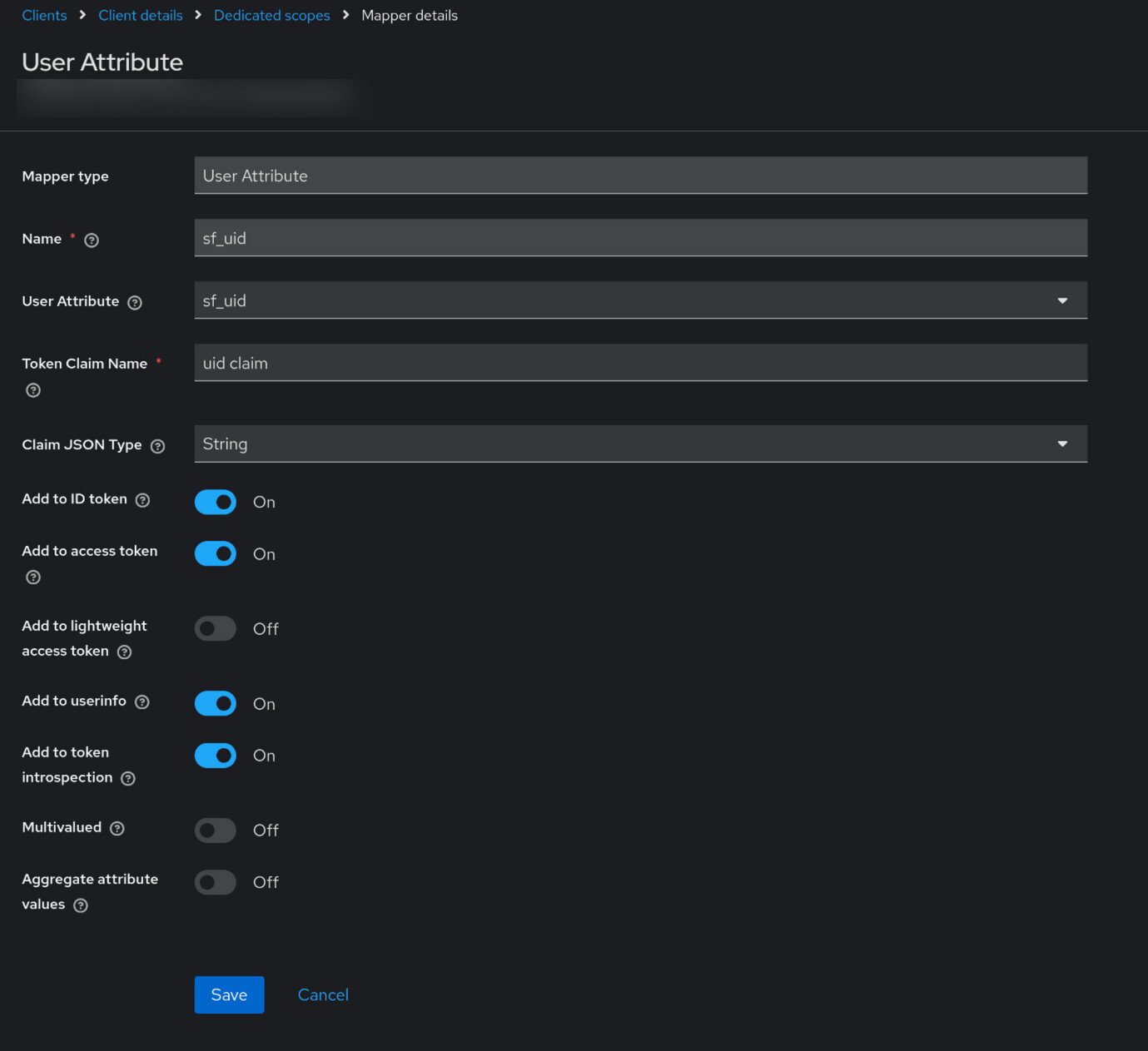

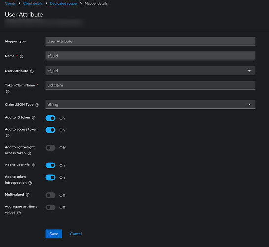

Hi, I’m currently testing on that and the only way I found this to work was to add a user attribute within KeyCloak hosting the xxxxxxx@auth.local local existing user ID. Then I’m passing that attribute upon OAUTHs and it matches.. Landing within the correct user libraries etc. Though, I’m unsure it is either very clean or elegant..
And the according OAUTH setup within seahub_settings.py:
OAUTH_SCOPE = [‘openid’, ‘email’, ‘profile’]
OAUTH_ATTRIBUTE_MAP = {
“uid claim”:        (True, “email”),                # ← match existing accounts on email
“email”:            (False, “contact_email”),       # ← match email address
“given_name”:       (False, “name”),                # ← optional
