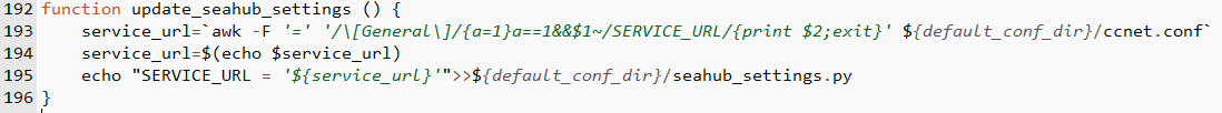

Hello! Could you tell me what exactly you changed in the script? As far as I understand, we are talking about this code fragment?

I didn’t change the script, I just read the script and added the service URL accordingly to the config file manually.
Could you show what, specifically, you changed in the configuration file (in this file: seahub_settings.py ?). The URL of your site does not have to be specified or can be covered up in the screenshot. Thanks!
Sure.
So in version 8 and before the service URL was in ccnet.conf like that:
SERVICE_URL = https://yourdomain.com
In Version 9 it has to bee in seahub_settings.py but the update script did not work in my case, so I added manually:
SERVICE_URL = ‘https://yourdomain.com’
Beware of the quotation mark at the beginning and the end of the domain name in the new file, that’s different from the old file.
