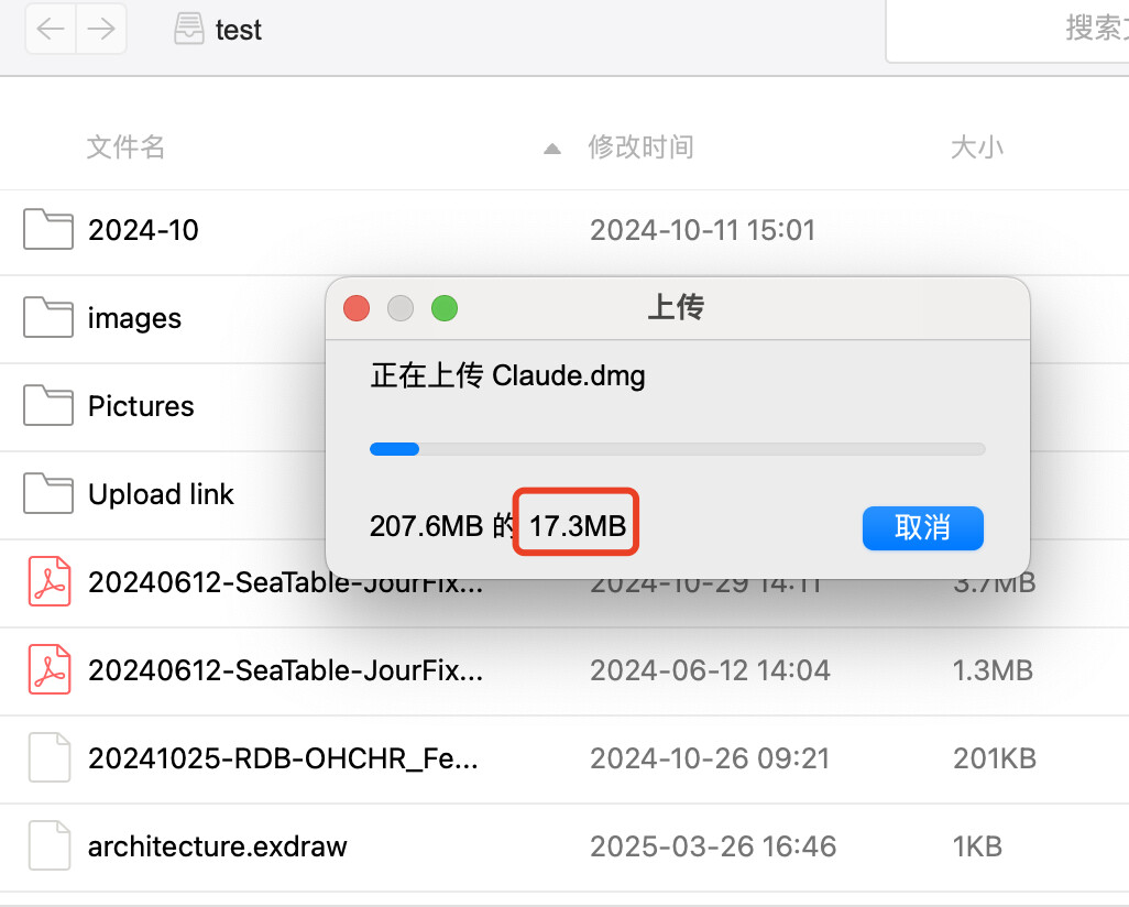

I cannot reproduce the issue. When I upload a large file via cloud file browser in the desktop client, there is a progress shown.
Maybe I misunderstand your problem. Do you have a screenshot?
This depends on the quota setting of your server. In plus.seafile.com, the default quota for trial account is 1GB.

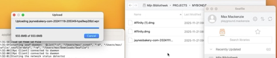

Hello Daniel,
sorry for the late response, but had to serve my customers first :slight_smile: i also created a screen movie, but this is not accepted by the community :frowning: so i had do make some screenshots. Hope you have a good weekend!

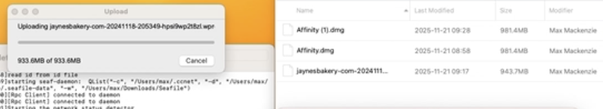

I indeed did not explain correctly. The incremental filesize works that is not the issue.

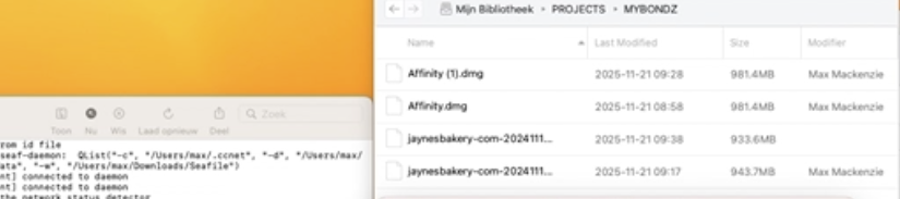

The problem is when the upload has finished, the Upload window stays forever (it looks like) in the status upload. While Seafile is doing something in the background?? The user is not warned …
See my example I upload a file with 933Mb, in the ‘Seafile Cloud file browser window’ looks identical, but as you closely look the filesize is different 943,7Mb.
The Upload window has no status change, and the file 933Mb is not yet available in the ‘Seafile Cloud file browser window’. This image you will see “as long as it is needed for Seafile to do it’s stuff”.
The ONLY way to see if Seafile is working is in the applog window. When finished you see in the applog window the upload is finished. And after this line the name of the uploaded file appears in the ‘Seafile Cloud file browser window’. :slight_smile: …. But as you can see (screenshot below) the Modifier is not mentioned .. and will only shown after a screen refresh or stop and start from Seafile Client.
My experience is when the file is bigger that 4.x Gb the waiting time is between 11-15 minutes before the Upload Status window disappears and the file is named in the ‘Seafile Cloud file browser window’.
