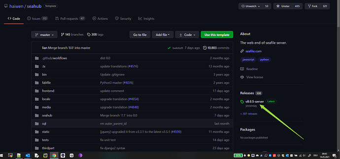

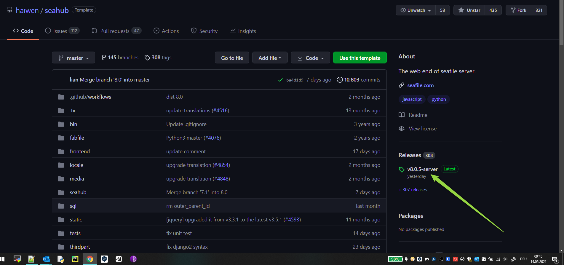

Out of curiousity: How did you manage to overtake the “official” server version of 8.0.4?
The v8.0.5
was released yesterday. When we built, we can chosse which tag should be. I could choose v8.0.4
, but its a no brainer.
See here seafile-server and seahub
