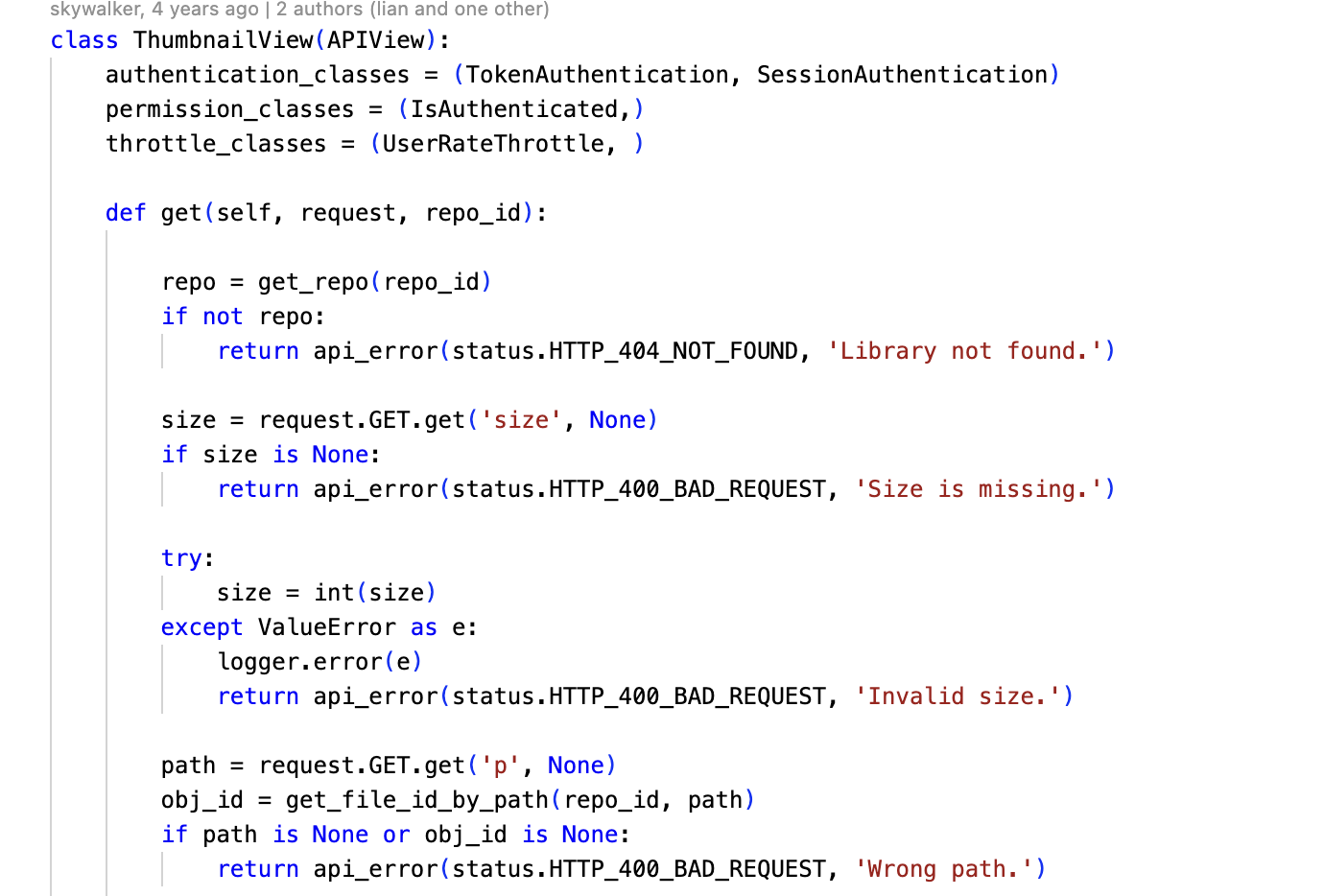

As we checked, the thumbnail API use token based authentication. It does not require CSRF check.
Do you know what might cause the Forbidden error then in Django? Is there some kind of logging I could activate to see why Django denies the request?
The path for returning thumbnail is like
"/api2/ repos/83066b00-67ef-4068-b738-7a7381558d1b/thumbnail/?p=%2F%E6%88%91%E7"%9A%84%E 7%85%A7%7%89%87%2F1. png&size=56
The related view function is ThumbnailView
Maybe you can add some logs to the view function to debug the issue.
After investigating the issue, I found that I only tested encrypted libraries in the mobile and desktop app. However these are explicitly denied: Source
Thumbnails for non-encrypted libraries work fine, both in the web and desktop/mobile clients.
My apologies for mixing them up. I was not aware that the repo encryption might matter.
