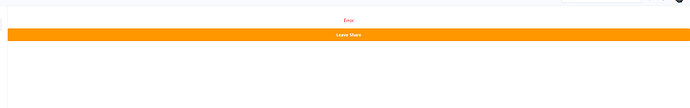

Now I can open seahub and I have access the my library list, but as soon as I connect to one I see this :
And in seahub.log in the container :
[2026-02-08 23:32:23] [ERROR] seahub.api2.endpoints.repos:115 get (1146, "Table 'seahub_db.base_usermonitoredrepos' doesn't exist")
I checked the list of tables in the db and indeed I can’t find it.
How can I make seafile work now ?
