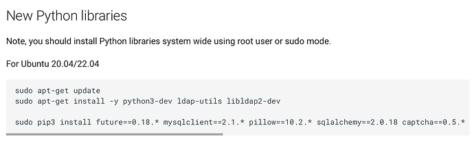

Ok, after installing (again) the python libraries from the manual
Seahub is now starting again and on a first check the sync seems to work.
Something must have gone wrong during my first installation of those libraries.
