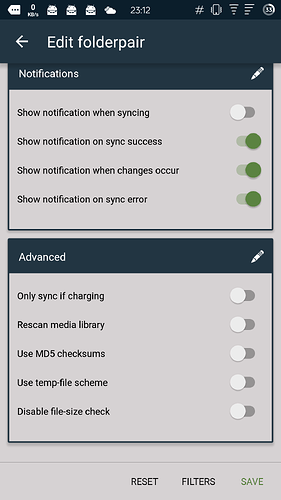

hi, I confirm that I have the same error using seafile on ubuntu 16.04. I thought it was a permissions thing at first, but now I see that it’s a bigger issue. Does anyone know a workaround yet ? I’m using foldersync using webdav and I bought the paid version of that app specifically because I want to back up the data on my phone each night
I notice there’s a bunch of files ending .tacitpart that get created when it tries to sync, does that give any clue?
For avoidance of doubt when I stopped Seafile Server 6.0.3 and restarted using Seafile Server 5.1.3, it syncs correctly.
It seems that some Webdav clients, including the ones I am using, first save a tmp file on the server, and then move or rename that to the real file name. It is this move/rename action that is failing.
So your files are probably backed up ok, but are just saved in the .tacitpart temp files for now.

That’s why Jacks workaround is working fine! Unticking the “temp” option in FolderSync makes uploading possible.
