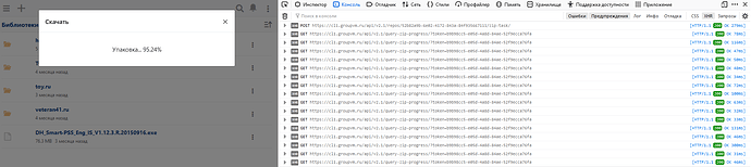

8.0.5 server is installed on debian (this problem also have been on a previous version of SF). Server on a virtual machine, from host to the VM with setup of proxy. The problem with downloading ZIP - directories and files of small size are downloaded well, directories larger than 5Mb - the message “Packing… 0%” hangs. Temporary zip files are created in the httptemp directory well.
If in browser (Firefox) call development panel by pressing F12 - packing goes step by step and all works correctly. If in browser switch off development panel, this problem appears again.

I noticed that when creating an archive, there are GET requests for each step of archiving, the result of each request adds percentages to the progress window. Maybe there is some way to change the number of requests - for example, increase the duration of each request?
It turns out that downloading ZIP works well on a small amount of files, because the next request does not have time to create.
