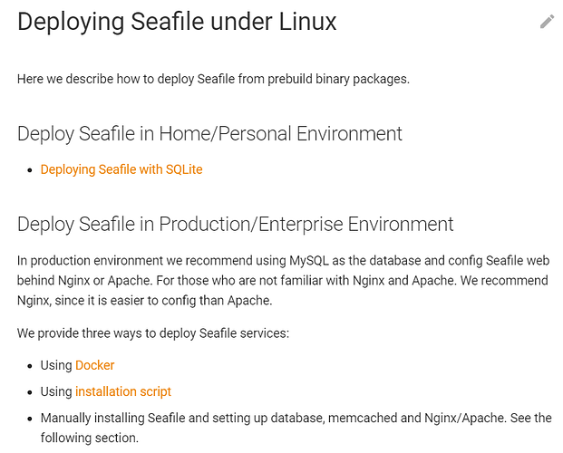

In the manual, the recommend ways to deploy Seafile are in the following order:
  1. Using docker
  2. Using installation script
  3. Deploy manually with MySQL
  4. Deploy manually with SQLite
The fourth way is rarely used. So we don’t put much attention to this one. The problem in this thread is related to it.

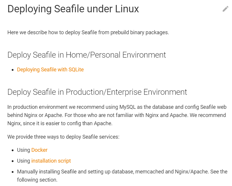

Actually SQLite is the first method but it does say personal/home:

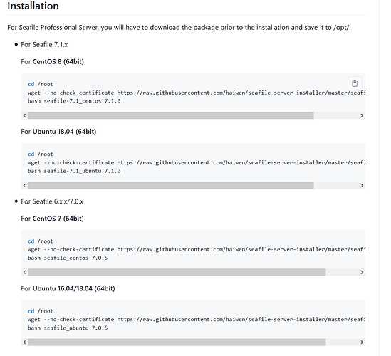

The reason I’m wary of scripts is that I like to understand what’s getting installed - even do that with Windows installs where I go and check what extras just got installed. Also, the script mentions only tested with Centos 7.1 and Azure gives you a later version of v7.9. Maybe incorrectly, but I expected it not to work. Although I notice that the guthub version for CentOS v7.1 was updated 3 months ago. Most new installs are going to be on the latest version of the OS.

1.) You recommend Docker as preferred deployment option - this information is not available in the manual. I personally did not know that, despite the fact that I work a lot with Seafile.
