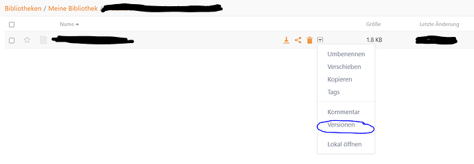

i am using seafile docker 8.0.3 behind an additional nginx reverse proxy to bind also other docker containers to port 80/443
When i want to see a file history in seahub…
I get the following Errormessage in the Webbrowser:
