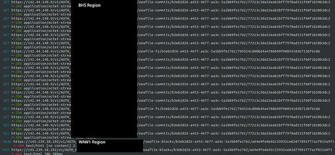

Here is a screenshot from mitmproxy of what’s happenning when uploading a file with a fresh install.
For the seafile-fs and seafile-commits containers the right region is used but not for seafile-blocks.
Even if the region is set to the same value for the three containers in the seafile.conf file.
