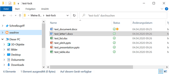

Hi Jonathan,
I did more testing regarding file locking (on two separate machines). My conclusion: File locking seems to indeed work reliably - which is great. But the display of the lock status is suboptimal (which I guess was the reason making me see a problem in the first place.)
So the display issue that I see on my two machines is as follows: Windows Explorer does NOT show the lock status when an Office file is opened. It ONLY shows the lock after performing another file transaction (opening/closing/renaming another file) in the same window triggering a refresh of said Explorer windows.
It is easy to reproduce:
After step 2, the opened file is not shown as locked. After 3, the file opened first is now shown as locked, the file you just opened is not shown as locked. After 3, all files are locked except for the last file opened .
I went for dinner after 3. and, when I came back, the last file was still not locked. Hence there is not automatic refresh mechanism that updates the lock status.
From a functional point of view, I think it is not a big problem. When opening the file, the fileâs ârealâ lock status matters meaning that a unlocked file shown as locked is opened in read-write. But it is a cosmetic problem and it may make people believe that file locking does not work properly. Is it an important problem? Note sure, but if there is a quick fix (i.e., a automatic refresh every 5 seconds) I would do it!
