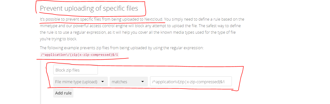

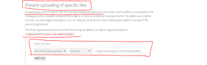

Indeed Seafile is really good platform to store data but there is some other features need to be added in seafile. NextCloud having a feature to prevent uploading specific file then why it can’t be incorporate in seafile. @daniel.pan Please consider this feature as it is much needed feature.
I would find this pretty useless. As a user you will always find a way around - rename the file, zip it or whatever. So purely “cosmetic” so that the admin can claim to have no videos or music file on the server without any idea if this is true or not.
