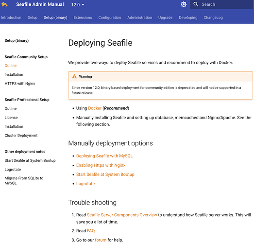

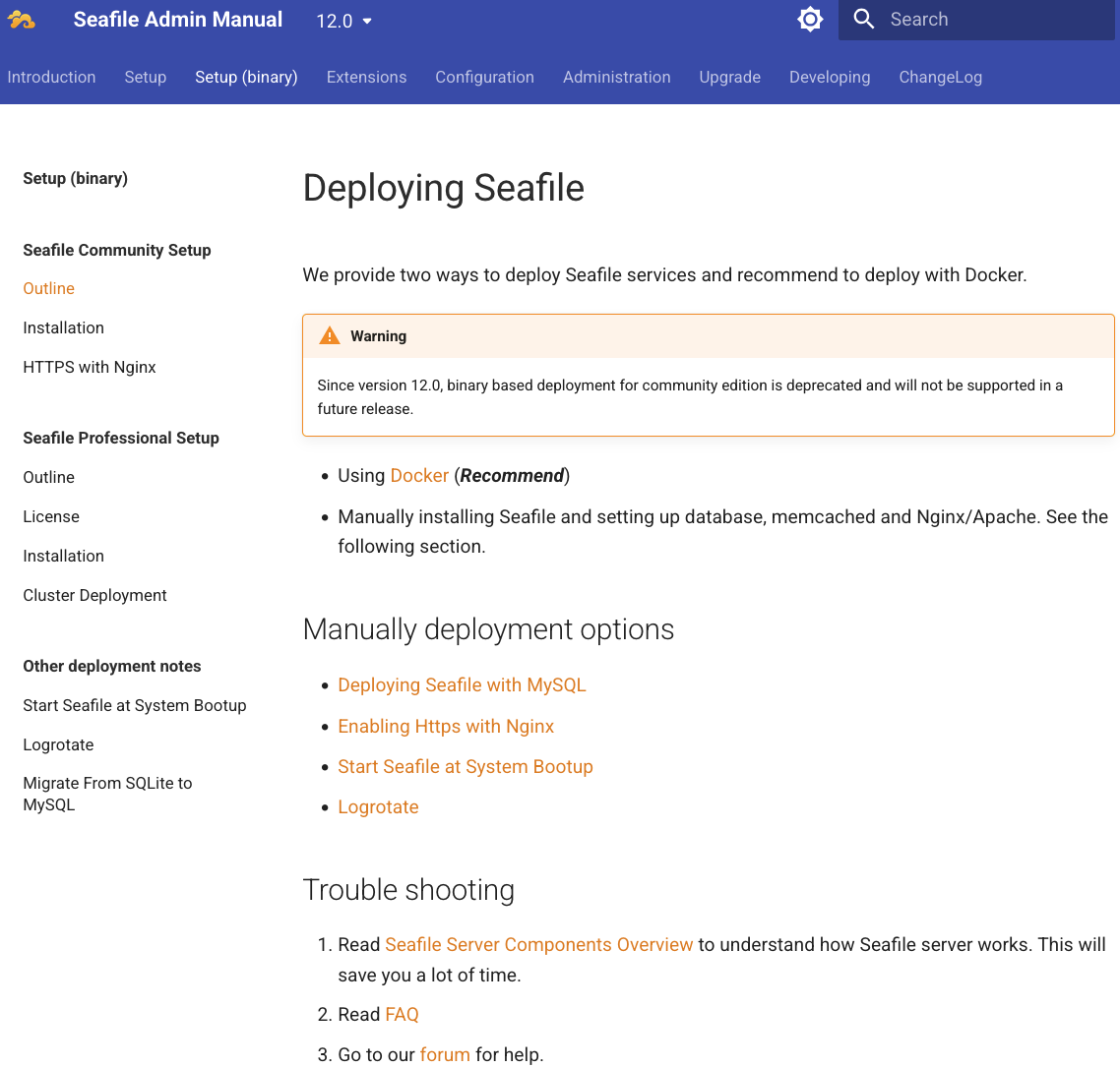

Where does one find the Server install manual?
Seafile Admin Manual. Note the pop-up menu at the top, next to the title, where you select the version (11-13). Topics, or chapters, are arranged horizontally across the blue header.
There is no meat in it all I see is
Introduction
I did find the following so I hope that its correct so can build my new server but ist for version 111
https://manual.seafile.com/11.0/deploy/using_mysql/
A PDF with install steps would be so much more helpful to me
I just found (not sure how) one for ver 12
https://manual.seafile.com/12.0/setup_binary/outline_ce/
The interface is not very clear, it seems.
Notice the ā€œ12ā€ with the down-arrow next to the title? That’s the menu where you select the server version of interest.
The horizontal tabs for each section (or chapter) are below the version selector: ā€œIntroduction, Setup, Setup (binary)ā€ and so on. Click to select a chapter of interest.
Does it make sense now?
Yeah I see that now but I’m used to reading top down. a PDF version would be ideal but Thank so much for the replies
