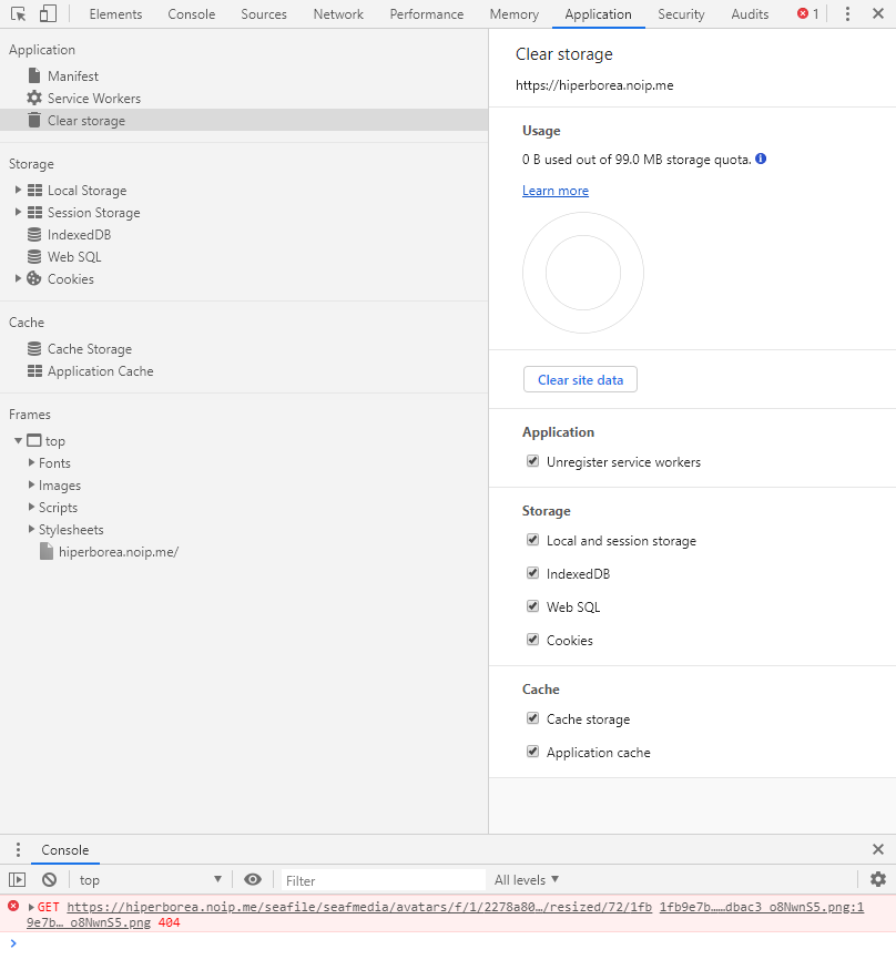

The problem that I’m facing is that the url has the /seafile/ in between and therefore I’m getting a 404 Server Error (not found):
https://hiperborea.noip.me/seafile/seafmedia/avatars/f/1/2278a8042266053fc3e798fb5e2f40/resized/72/1fb9e7bb2be3e0fa49a3655ef7fdbac3_o8NwnS5.png
and it should be:
https://hiperborea.noip.me/seafmedia/avatars/f/1/2278a8042266053fc3e798fb5e2f40/resized/72/1fb9e7bb2be3e0fa49a3655ef7fdbac3_o8NwnS5.png
The others pictures, seafile-logo, icons, are still served from /seafmedia/

The config was not changed. Seahub cache (in my case memcached) was empty. I tried deactivating memcached as well, and flushing seahub_cache.
root@hiperborea /home/seafile/logs # tail -f seahub.log
2019-07-16 19:13:24,725 [WARNING] django.request:152 get_response Not Found: /seafile/seafmedia/avatars/f/1/2278a8042266053fc3e798fb5e2f40/resized/72/1fb9e7bb2be3e0fa49a3655ef7fdbac3_o8NwnS5.png
2019-07-16 19:13:24,727 [WARNING] django.request:152 get_response Not Found: /seafile/seafmedia/avatars/f/1/2278a8042266053fc3e798fb5e2f40/resized/64/1fb9e7bb2be3e0fa49a3655ef7fdbac3_o8NwnS5.png

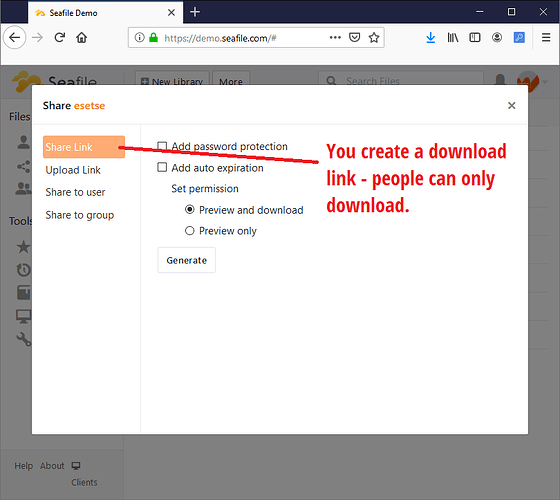

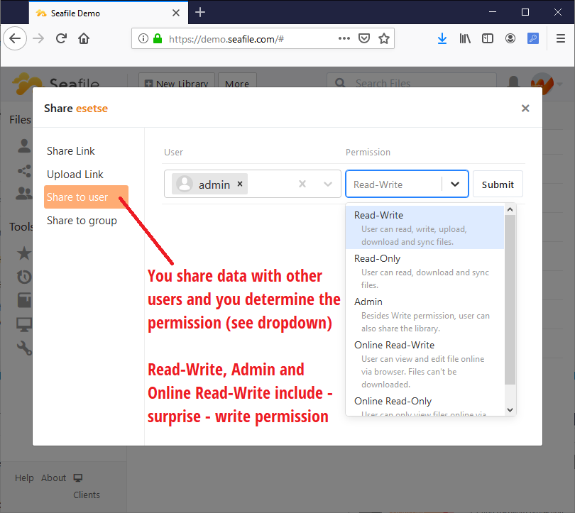

This are screenshots from the Seafile demo system, which is Seafile PE. But you can do just the same in CE.
I see.
I thought the upper share link example was to get a rw edition too.

I, personally, am lukewarm about the combo link (up- and download). I think sensible use cases are rare. In any case, it can be emulated by two separate up- and download links.
