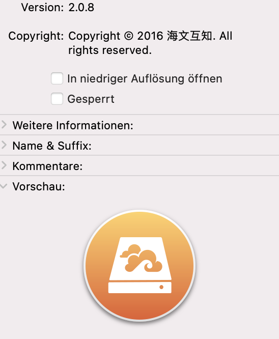

SeaDrive fails to start on Big Sur (11.0.1). Error message: “Failed to initialize: failed to install kernel driver”. Any idea how to debug or fix?
Are you sure you use SeaDrive 2.0.8?

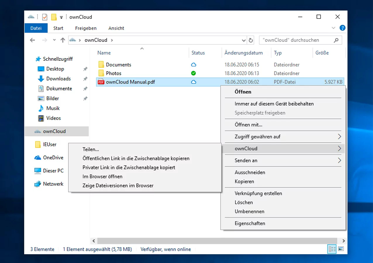

@Jonathan: On topic of SeaDrive’s context menu integration under Windows, I happened to find out that owncloud’s desktop client, which also uses Windows Cloud Files API, does just that:
This is the page where I found the screenshot: Virtual File System - ownCloud Maybe worth checking how they do it…

Thanks for the information. We’ll check.
